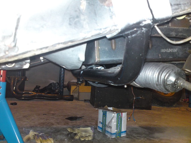

Dart_R5P7
Joined: 25 Dec 2008
Posts: 103
Location: Espa
PostPosted: Sun Mar 08, 2009 11:52 pm    Post subject: Reply with quote
Legger ut litt mere bilder da
 Filesize:  94.58 KB
 Viewed:  26252 Time(s)
 Filesize:  100.9 KB
 Filesize:  87.41 KB

Dart_R5P7
Joined: 25 Dec 2008
Posts: 103
Location: Espa
PostPosted: Sun Mar 08, 2009 11:55 pm    Post subject: Reply with quote
Mere bilder....
 Filesize:  85.61 KB
 Viewed:  26265 Time(s)
 Filesize:  83.95 KB

Black_CUDA
Forward Look
Joined: 19 Dec 2008
Posts: 53
Location: Stange
PostPosted: Mon Mar 09, 2009 11:21 am    Post subject: Reply with quote
Næmen Roy da. sette grombremser på Dirt'en!? du har vel ikke tenkt å klare å stoppe driten og? har du blitt bløt? Laughing
neida, ser nice ut det gutten! rock on dude! Cool
