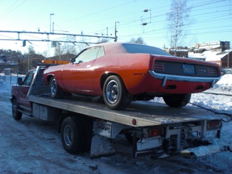

PostPosted: Sun Feb 22, 2009 12:40 pm    Post subject: Reply with quote
Sikkert den her du har sett?
 Filesize:  66.49 KB
 Viewed:  24799 Time(s)
70 Plymouth Barracuda Pro-Touring Hemi
x 70 Dodge Challenger R/T Clone
x 67 Dodge Dart GT
x 73 Plymouth Duster
PostPosted: Sun Feb 22, 2009 12:44 pm    Post subject: Reply with quote
Flakbilen la eg knapt merke til, men fargen på Cudaen og med sort bakplate stemmer. Lekkert Razz
